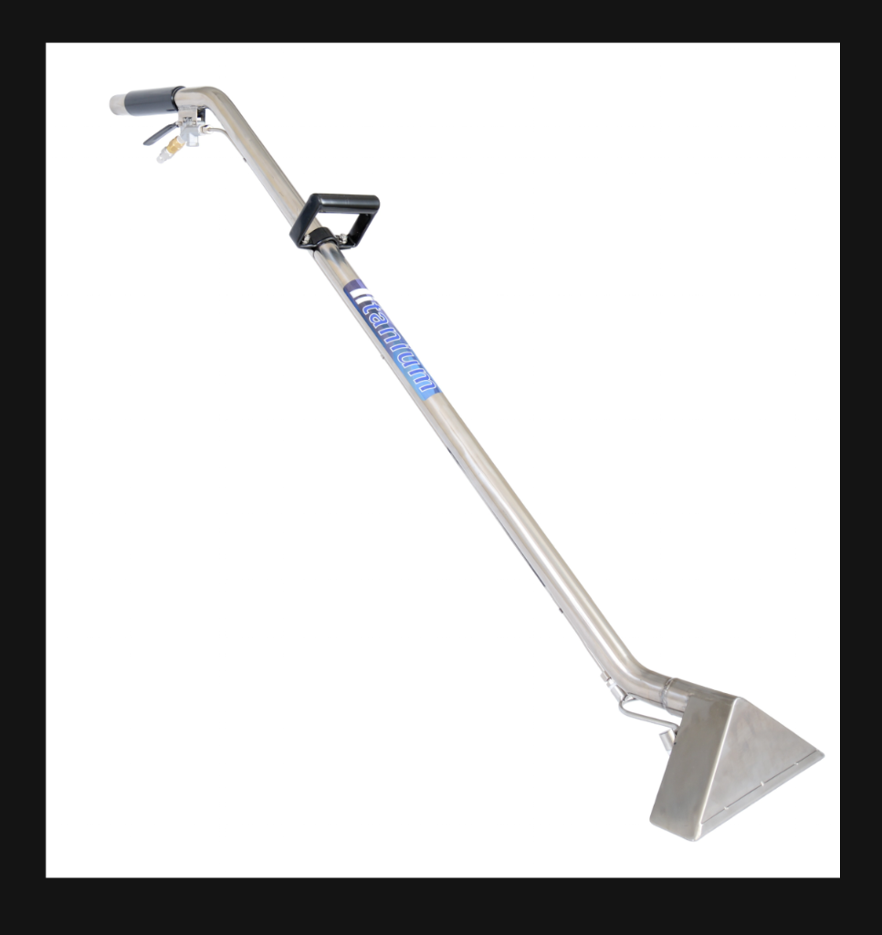

What is it about it that sucks? If you dont mind, please give a 20 second pitch of why it is not worth the metal it is made of. Get technical. Go.
117,285
My Teflon Glide fixes 80% of what's wrong with it..
Lockdown, chatter, not cleaning to the edge
Not being a S bend is probably 10%
The other 10% would be the lack of velocity to the overly large vacuum chamber that supposedly has "laminar flow" working for it but to me if that thing doesn't whistle that tells you something...

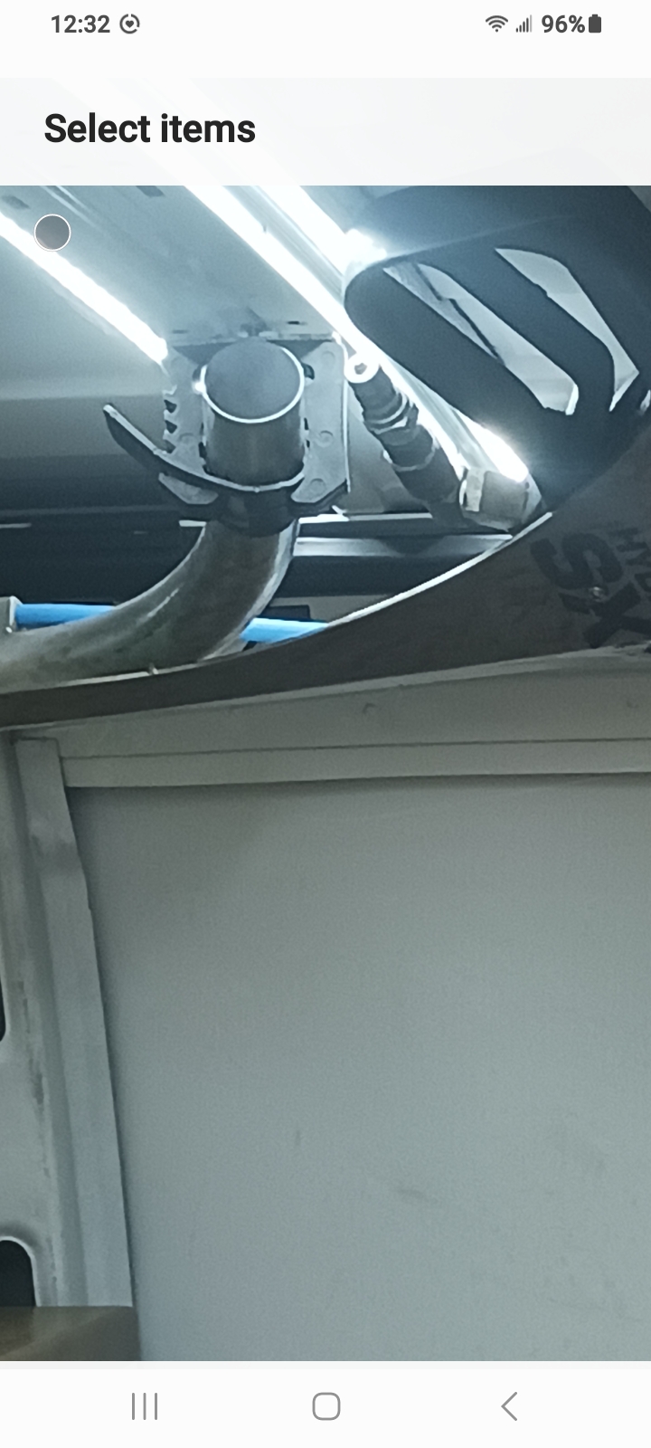

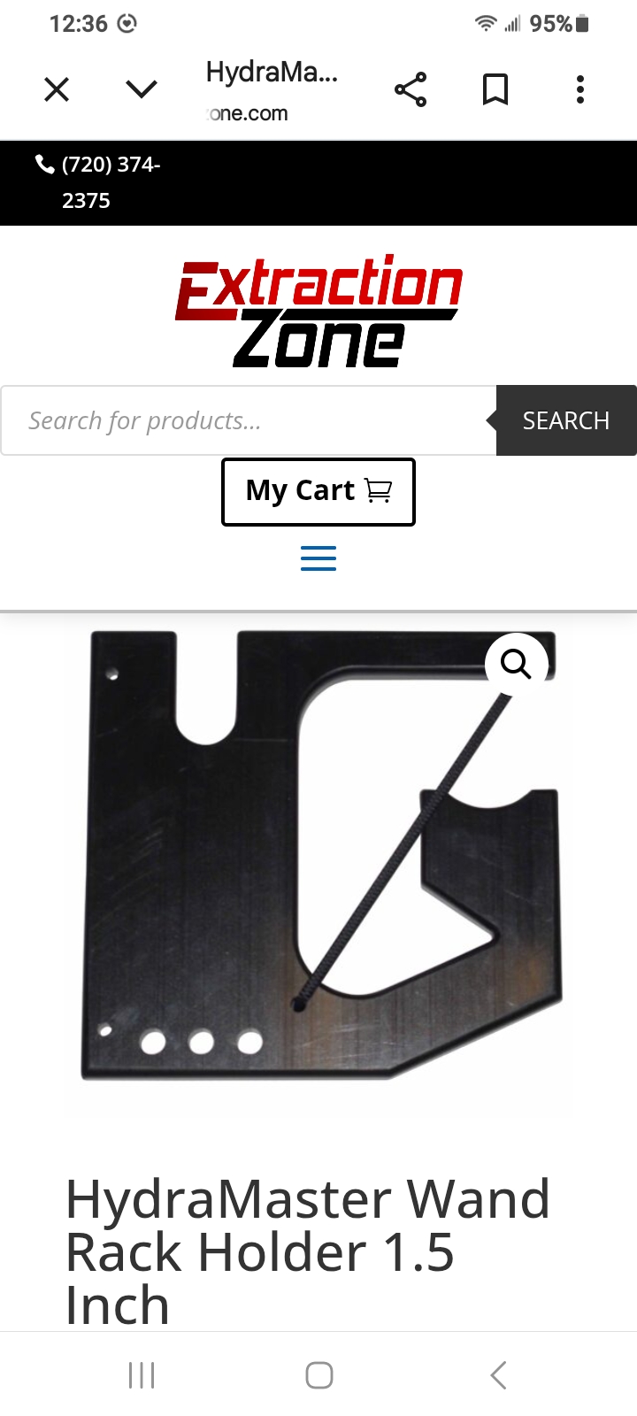

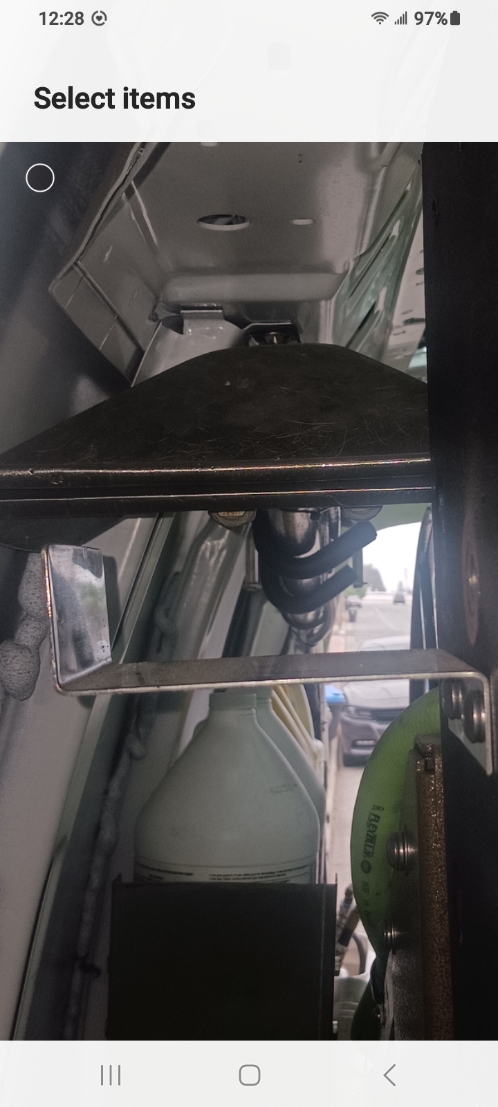

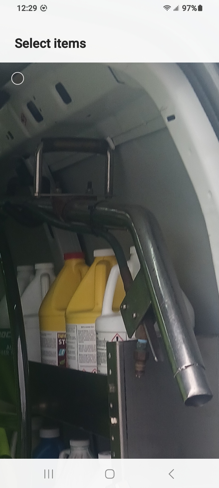

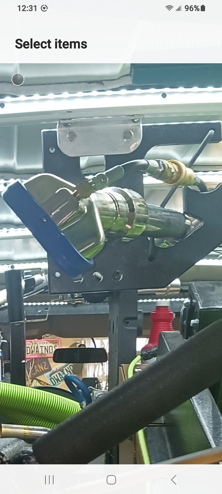

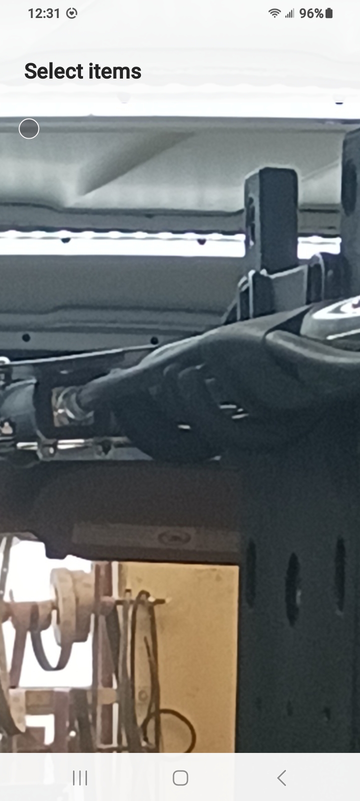

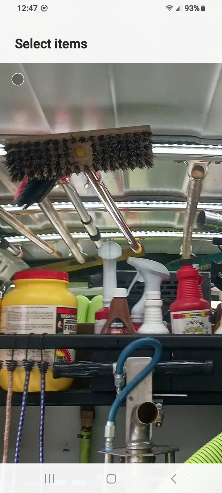

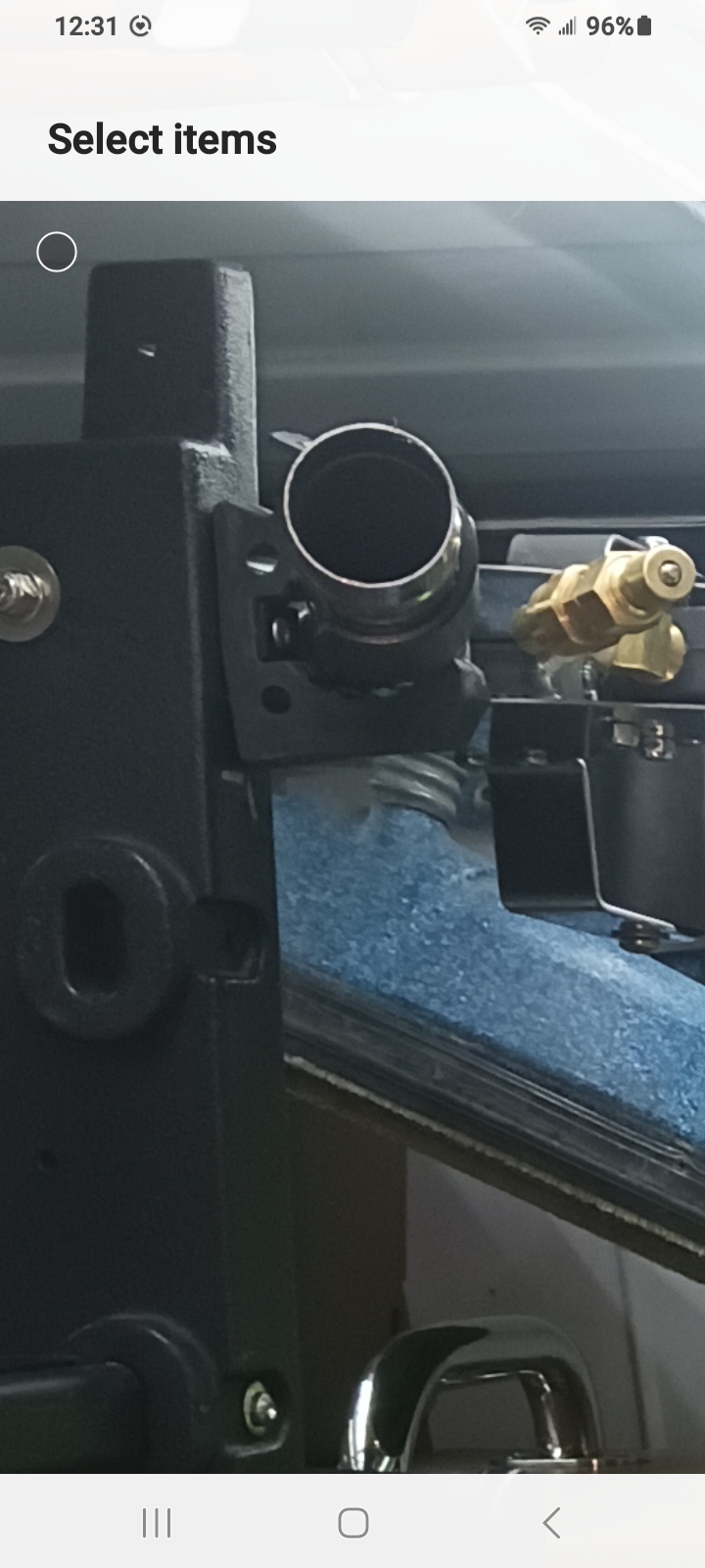

So then....you've attached mounts that holds yor wand on the wall of yor van.....great idea! Saves space I'm sure...
Dwain Ray
Jul 22, 2020
1,175

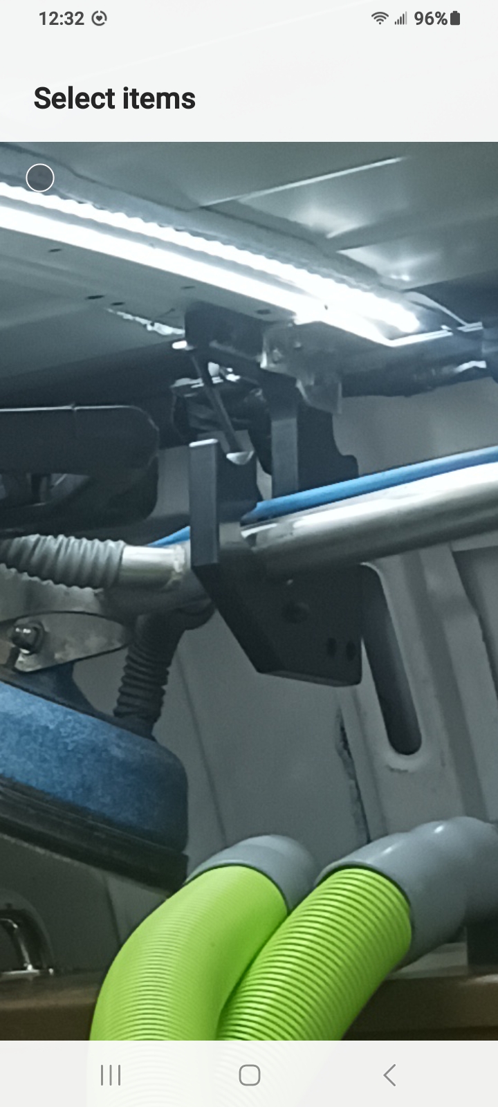

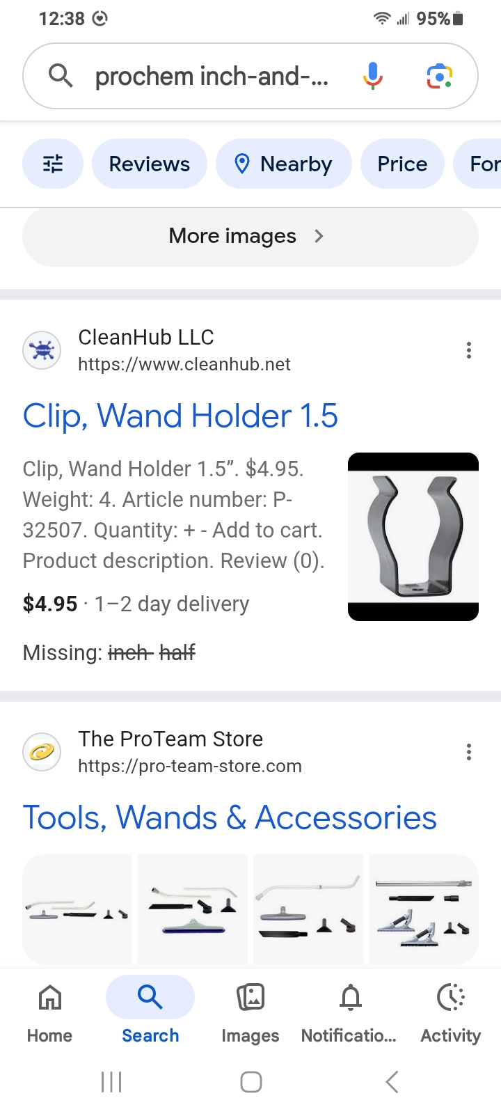

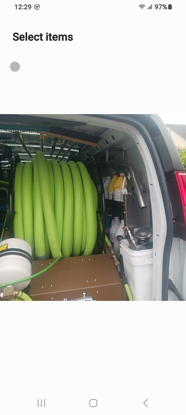

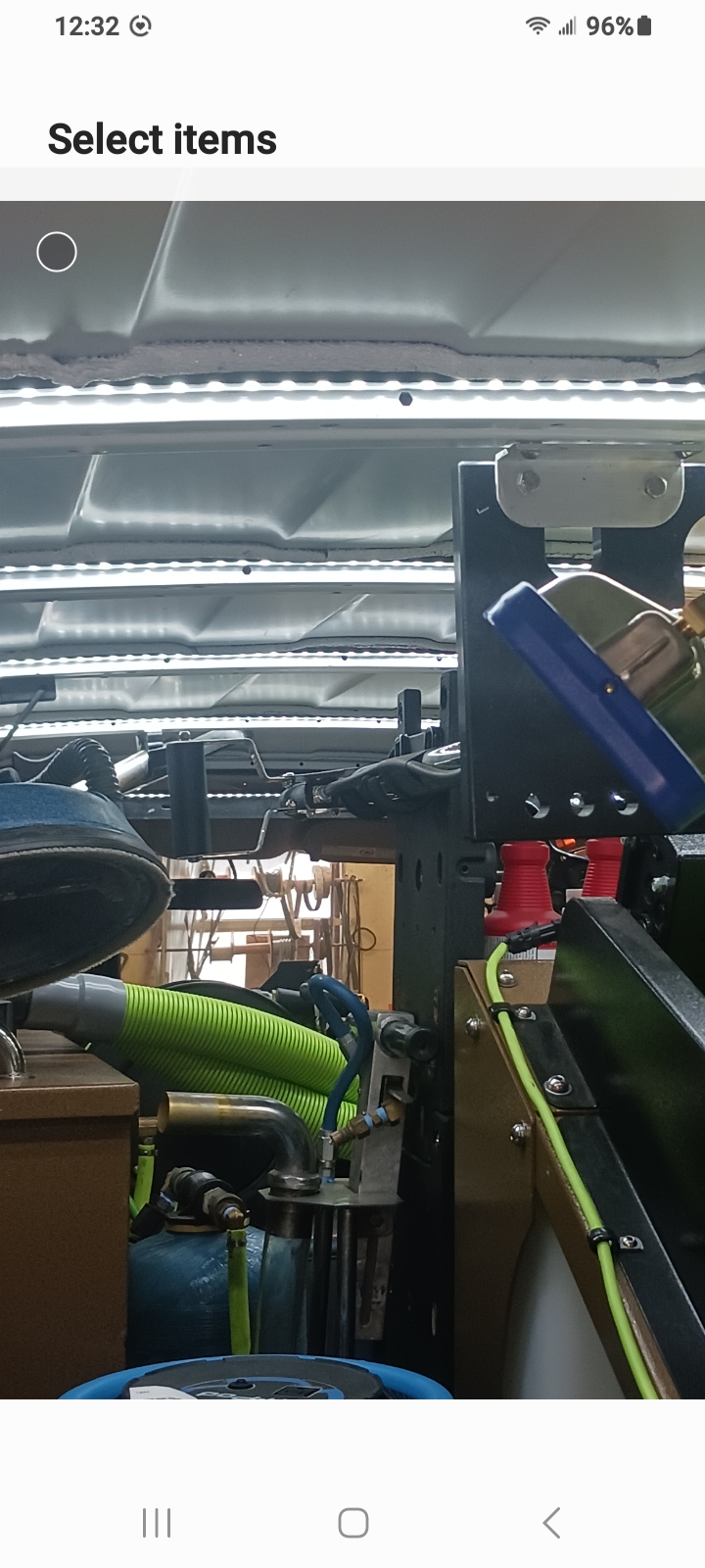

I did, for a regular scrub wand i used a wall mount bicycle rack and a prochem 1½" wand clip. For my gekko wand i used a home depot garage tool hanger with½of a hydramaster wand holder assembly to hold it and a 1½" rubber tool clamp to hold it in place. For my 15" spinner i used the other half of the hydramaster wand holder assembly and another rubber tool clamp to hold it up and a 8"×8" sticktape foam for protection for brushes ,rakes mops etc a used spring clamps on one end and pipe straps on the other In 3 years only 1 carpet rake has fallen ( on a washboard dirt road). Everything is secure, organized,no rattling around and frees up alot of floor space.when customers come out to see this custom Frankenstein thing (and they do, its encouraged) i show them not a pos setting in there drivway leaking, instead a well organized clean system that reflects pride of ownership and quality workmanship. And yes at least ½ the people i work for has had the "Frankenstein experience " and i regularly get calls from new clients saying that they heard from another customer that i have some special equipment i bring to clean .... and the show starts again. Everything in your van should have and be in its place. This is a lesson i took from the military "gear adrift will sink ships"

Numero Uno
1,942
Caesar
All this about how to store brushes and wands. The only thing,I ever disliked about my Butler were the rake holders. Your in the Van going for stuff,suddenly you scalp your head. So I took a 1 foot section of pvc pipe and capped one end. Took another 6 inch section .Took some left over Butler neoprene foam from lid gasket and glue a 6 in strip on the inside. Took magnets an attached to the 12 inch and 6 inch section .Placed on inside of roof inserted rakes /brush.As yrs went on and We became top heavy in Window cleaning.We did same with the Unger extension poles. No need to drill,nothing to scuff head against.For under 5 bucks at the time done. Now for wand ,I suggest a large plastic holding case with a hinge or metal if you care to make one. Apply some serious heavy duty magnets to the box place on inside roof,insert wand,close to secure. Magnets will hold if long enough and strong enough.Pop off if you need to sell or work in van an need space...Clamps /holders all enable it to be in the way . You need the space -correct.Well nothing has more space then your inside roof...Regards. !
